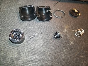

+[title] Separate the button.
+[* black] The "lid" is held on by 4 plastic "rivets". Carefully put a knife blade in between the small lid and pry them apart. Carefully remove the inner spriIngs and plungers. In the picture one small plunger is still in the top of the button.
