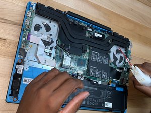

+[* black] Attach the air straw to the compressed air can.

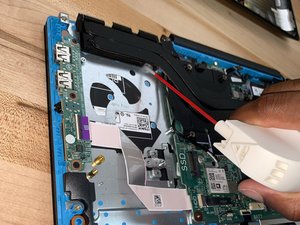

+[* black] Begin gently cleaning areas of collected dust around fans and air intake vents.
+[* black] Warning: keep 6 inches away and do not use full pressure. The can get really icy cold
