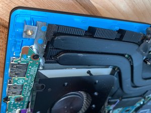

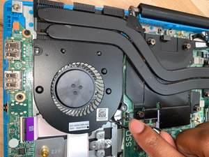

+[* black] Locate the left fan and unscrew two #1 Philips head screws.
+[* black] Unplug the left fan from the device and pull away from the device.
