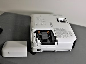

+[* black] Use your screwdriver to loosen the screws attaching the bulb to the projector by twisting counterclockwise.
+ [* black] You only need to loosen the screws since they do not remove from the bulb completely.
