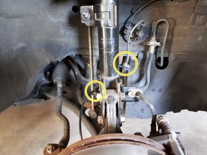

+[title] attach the rest

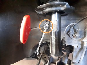

+[* orange] Connect the stabilizer bar link. Tighten to 50 N·m.
+[* red] Bolt the brake cable bracket back on to the strut assembly. Tighten to 25 N·m.
+[* yellow] Attach the sensor cable to the mounts on the strut assembly.
