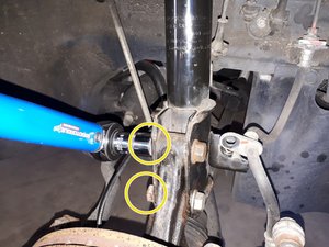

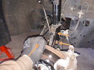

+[title] insert strut assembly
+[* black] Carefully put the strut back and while holding the bottom part, screw back the bolt.
+[* red] Using the 6mm hex and 17mm wrench, tighten to 50 N·m and enclose with the plastic cover.
+[* orange] Push against the wheel hub to align the wheel arm with the strut bracket and insert the strut bracket bolts.
+[* yellow] Apply thread locker and screw the bolts back on, tighten to 90 N·m.
