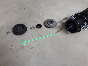

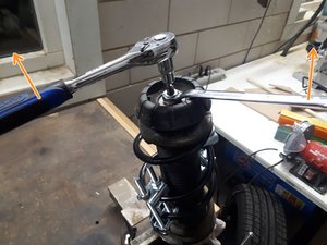

+[title] remove top from strut assembly
+[* red] Use the coil spring compressors to release the tension on the strut assembly head.
+[* black] Use the vise to hold the bottom part of the assembly. Wrap it with some cloth to prevent damage from the grips.
+[* orange] Use the 6mm hex to hold the bolt in place, while loosing the nut with the 19mm wrench.
+[* green] Release the strut assembly from the vise and take off all parts from the top and arrange them by order.
