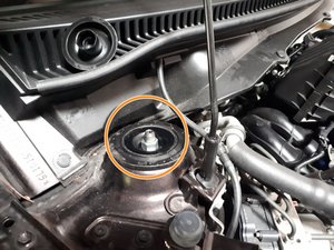

+[title] remove strut assembly
+[* red] Pull the wheel arm from the bottom strut assembly.
+[* orange] Open the hood and remove the plastic cap protecting the upper strut mount.
+[* black] Use the 6mm hex to hold the bolt in place, while loosing the nut with the 17mm wrench.
