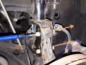

+[title] disconnect bottom strut assembly
+[* red] Put the jack under the wheel arm and let the jack bear the weight of the arm but not lift the arm.
+[* yellow] Using the 17mm socket, unscrew the nuts from the bolts attaching the strut assembly to the wheel arm.
+[* orange] Use the punch and hammer to punch out the bolts.
