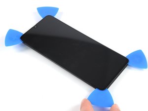

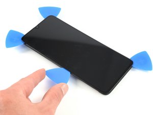

+[title] Slicet the adhesive
+[* black] Insert a fourth opening pick under the top left corner.
+[* black] Slide the opening pick along the left edge to cut the adhesive.
+[* black] Leave the opening pick in the bottom left corner so prevent the adhesive from resealing.
