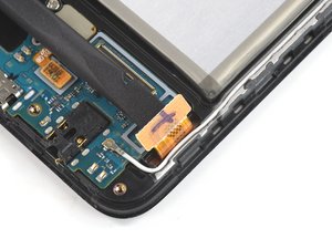

+[title] Disconnect the display connector
+[* black] Use the flat edge of a spudger to pry up and disconnect the display connector from its daughterboard socket.
