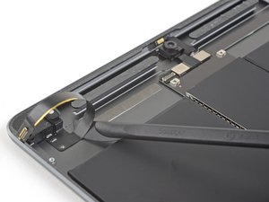

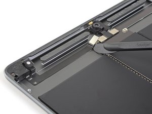

+[title] Peel up the headphone jack cable
+[* black] Insert a halberd spudger underneath the headphone jack cable.
+[* black] Slide the halberd spudger towards the headphone jack to cut the adhesive securing the cable to the rear case.
