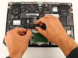

+[* black] Lift up the speaker on the right and start unwinding the cable from the hooks.
+[* black] Thread the right speaker underneath the trackpad ribbon cable.
