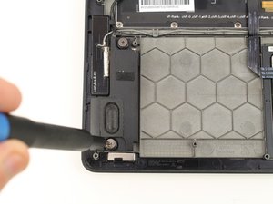

+[* red] Remove the four 2.4 mm Phillips #00 screws from the speakers on either side of the case. (two screws per speaker)
