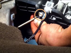

+[* red] Now you need to be under the shifter bezel, on the floorboard. If you follow the rod coming from the transmission you will see it is not attached to anything.

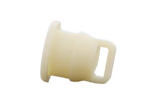

+[* black] You will see a hole within the rod. That is where your bushing should be. You will push the bushing form the back side of the rod towards the driver side. The that is not a flat side should be facing the driver side. You may need to put a little grease on it, as it will be a little difficult to push in. Pliers will help you push it in also.
+[* orange] .Now that you have the bushing installed, you will reach into the mechanism and clip it in towards the passenger side.
