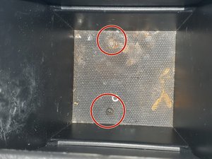

+[* red] Unscrew screws within the storage compartment.
+[* black] Pull up on your emergency brake as high as you can get it.
+[* black] Remove the middle and rear section of the console to remove the front section
+[* black] Grab the sides of the console and start to wiggle it until you hear the sections unsnap from each other.
