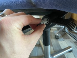

+ | [title] Removing the armrest on the other side |
+ | [* black] Remove the two screws from the other side of the chair (on the other, remaining armrest) |
+ | [* black] Remove the armrest similarly to the other side, along the screw axis |
+ | [* icon_note] This side can be slid off easily, since the bottom axis will come out with the armrest |
+ | [* black] Mind the two circular plastic washers on the lower axes |
+ | [* black] Mind the two plastic inner washers (that are parallel to the axes |
+ | [* icon_note] The second (parallel) washer on the side, where the first armrest was before, can be removed by pulling the shaft out a little, and then pushing it back (slightly tilted), thus pushing the plastic washer out |
+ | [* black] Finally, the shaft may be removed from the other armrest as well, however, it can be stuck sometimes (you could possibly use a plier, but it can damage the shaft's surface) |
