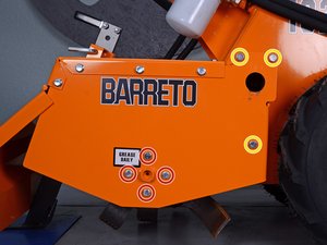

+[* red] Use a 9/16 inch socket to remove the four bolts securing the tine shaft to the side plate.

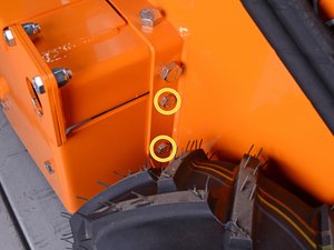

+[* yellow] Use a 9/16 socket and wrench to remove the five bolts and accompanying nuts securing the side plate to the frame, three on the outside and two in the wheel well.
