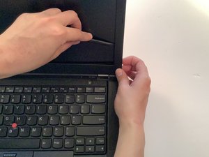

+[* red] With the Phillips head #0 screwdriver, unscrew the two 50 mm screws securing the plastic display case.
+[* black] Wedge the flat end of the spudger in between the display case and the screen. Unsnap the top case from the bottom piece holding the screen.

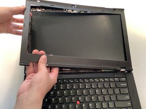

+[* black] Remove the case and set it aside.
