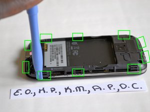

+[* black] ***Remove the back case.***
+[* black] Use one hand to hold the device in place. With using your free hand take the plastic opening tool and stick it in the gaps on the sides on the phone (as highlighted in the picture). Pull the plastic opening tool downwards so that the plastic case will pry open.
+[* black] Start the prying method at the same position as shown and work clockwise. ***BE CAUTIOUS: DON’T BREAK THE CLIPS*** (you can damage the frame this way). Pry it gently until you hear it click and start to see it open.
+[* black] ****Note**** ''after the clips are disengaged, there are no cables holding the back panel in its place, you should be able to pull the back case open easily.''
