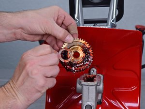

+[* black] Remove the worm gear and left worm gear thrust washer from the worm housing.
+[* black] Separate the left thrust washer from the worm gear.
+[* icon_reminder] During reassembly, insert the worm gear into the housing before inserting the thrust washers next to it on either side. All three will be aligned properly once the tine shaft is reinserted.
