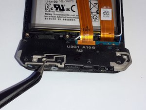

+[* icon_note] There is a plastic tab securing the top left corner of the daughterboard cover.
+[* black] Use a pair of tweezers to lift up the bottom of the daughterboard cover to a ~30 degree angle.
+[* black] Pull the daughterboard cover straight out, away from the phone.
