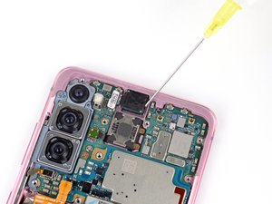

+[title] Soften the camera module adhesive
+[* black] Apply high concentration (over 90%) isopropyl alcohol to the gaps around the front-facing camera module to help soften the adhesive securing it into place.
+[* black] Give the alcohol a minute to penetrate the adhesive.
