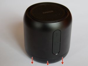

+[* black] Remove the 3 screws using a screwdriver.

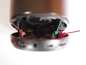

+[* black] Pull the lower part carefully to open the casing. You may use a slotted screwdriver, plastic card etc. along the slit to open as the cables are fixed with sealing paste inside.
+[* black] When the slit opened, remove the red battery cable plug and the white speaker cable plug (red arrows) from the socket by pulling and the volume/play control cable by pulling the black lash (green arrow) upward and pulling the cable out of the socket.
