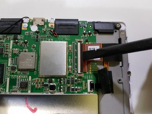

+[* black] Lift up part of the tape covering the frontlight connector.

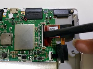

+[* green] Using the flat end of your spudger, disconnect the display.
