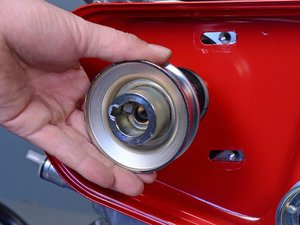

+[* black] Remove the motor pulley.
+ [* icon_note] Keep track of the key in the keyway and remove it with the pulley.
