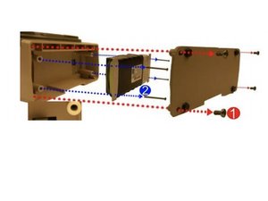

+[* black] Remove the battery by unscrewing the (4)Phillips 6-32 X 2 ¼ screws and detaching the plug from its locking latch. This is indicated in the second picture in blue with the number 2.
