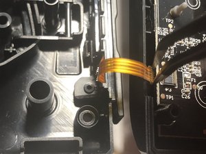

+[title] Disconnect ribbon cable
+[* black] Use a plastic spudger to flip the ribbon cable latch up as shown in the first two images.
+[* black] Remove the ribbon cable from the slot by pulling to the left with tweezers or fingers gently.
