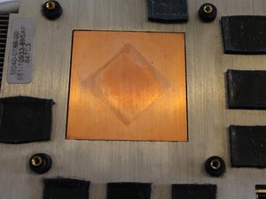

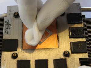

+[title] Clean the radiator
+[* black] Put some 70 or 90 degree alcohol, wait a bit for the thermal paste to get wet then clean with a piece of makeup cotton, repeat until you get a proper result like in the third pic.
