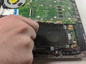

+[* red] Unscrew the five 4.8mm Phillips #00 screws holding in the hard drive mounting bracket.
+[* black] Slide the mounting bracket towards the battery to disconnect the hard drive from the motherboard.
