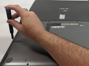

+[* black] Open the laptop until it is flat and lay it screen down
+[* red] Remove eight 9.6mm Phillips #00 screws from the bottom of the laptop.
+[* orange] Remove two 4.8mm Phillips from the corners of the device.
