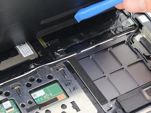

+[* black] Pry the battery out with your hands.
+[* icon_caution] Be careful not to bend the battery. Breaking the battery is dangerous.
+[* icon_caution] Use a plastic spudger underneath the battery to pry off the adhesive strips keeping the battery in place.
