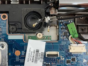

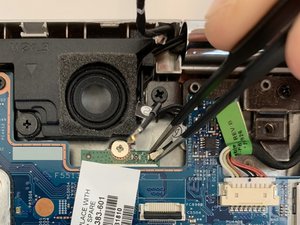

+[* red] Use the same Precision Tweezer Set to disconnect the Antenna Cable labeled, A1, which is connected to Port #1. (This cable is marked in red in the previous step).
+[* black] Pull out both of these cables from their track next to the speaker.
