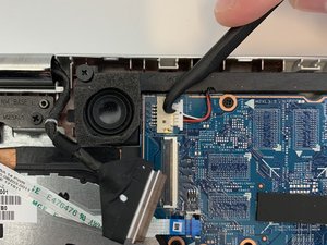

+[* red] Using the Halberd Spudger, disconnect the Speaker Cable from the port that connects it to the motherboard. To do this, use the curved end of the spudger to pry it out from the port.
+[* orange] Using the Halberd Spudger, disconnect the DC Power Jack Cable from the port that connects it to the motherboard. To do this, use the curved end of the spudger to pry it out from the port.
