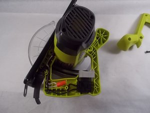

+[* black] In order two remove the plug from the saw you will need to disconnect the two wires that come from the plug.

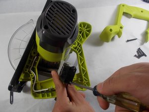

+[* black] In order to remove the black wire, simply unscrew it from the trigger switch using the #2 Phillips screwdriver.

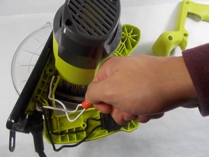

+[* black] In order to remove the white wire, twist off the plastic wire nut to separate the two white wires.
+[* black] After disconnecting the two wires the plug will be free of movement, allowing you to remove it.
