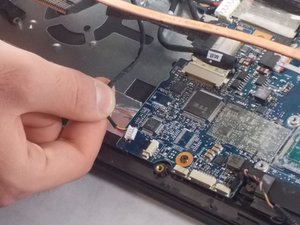

+[* black] Disconnect the fan cable from the motherboard by carefully pulling on the black wire at the point closest to the white tab.
