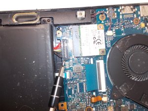

+[* black] The battery contains wires connecting it to the motherboard. Slowly pull up and disconnect the wires from the board by pulling on the black tab using hand or tool.
