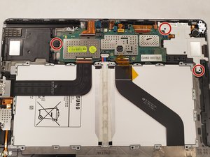

+[* black] Locate the three screws that fasten the speakers. Then remove using #00 Phillips head screwdriver.

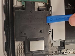

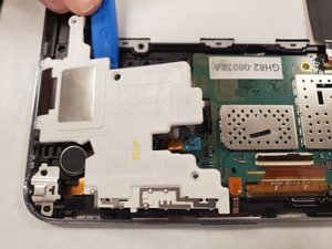

+[* black] Then using the blue opening tool, pry up the speakers from the clips that hold them.
