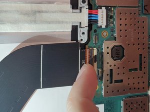

+[* black] Locate the four ribbon cables attached to the motherboard.
+[* black] Using your finger or the blue opening tool, pry on the tab that secure the ribbon cable in place. Then remove the cable from the motherboard.
