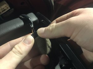

+[* black] Before you can start removing the side panel, the speaker on the driver side door must be removed. To do this simply squeeze it and will pop out. There is a little wire that connect the speaker to the car. To detach it there is a little button that can be pushed and it will come lose.
