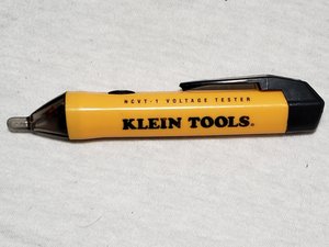

+[* black] Determine there is no power at the outlet using a magnetic field tester. Place the tester against each screw on the side of the outlet.
+[* icon_note] The tester will typically emit a red light and make noise when there is power and will emit a green light when there is not power.
