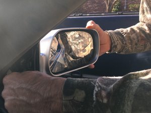

+[* black] Loosen and remove the three 10mm bolts using your socket and ratchet.
+[* icon_caution] Ensure you are holding the mirror so it does not fall to the ground while removing the bolts.
