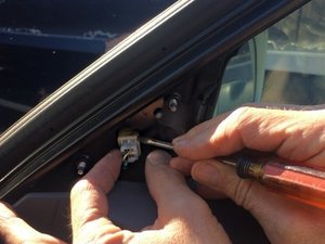

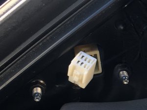

+[* black] Detach the electrical connecter completely. Place your flathead screwdriver in the gap to gain leverage and pull on the connector.
+[* icon_reminder] Be careful not to pull on the wires.
