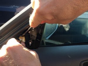

+[* black] Begin to disconnect the electrical connector located in the center of the three 10mm bolts.

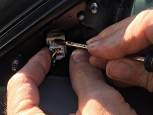

+[* black] Press in on the electrical connector. Then use your flathead screw driver to press in on the lock pad.
+[* black] You can locate the lock pad by looking at the release tab on top of the electrical connector.
