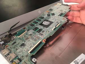

+[* black] Use a 000 Phillips head screwdriver to unscrew the final four screws holding the Motherboard in place as indicated in the photo.
+[* black] You should now be able to remove the Motherboard, if you cannot remove it make sure all your screws have been removed and nothing is holding the Motherboard in place.
