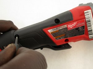

+[* red] Using a Torx T20 screwdriver, unscrew the four M4 x 16mm screws
+[* orange] Switch to the Torx T10 screwdriver, and remove the M4 x 16mm screw.
