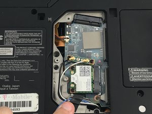

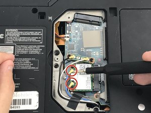

+[* red] There are two connectors that need to be detached from the WiFi card in order to remove it.
+[* icon_caution] Very gently pry up on the connection points. It is very important to be careful with these connectors because they are difficult to replace or repair.

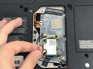

+[* black] Once both connectors have been detached, carefully hold the wires back to have access to the WiFi card.
