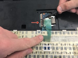

+[* red] With the top ribbon connection folded back, use the tweezers to carefully remove the bottom ribbon connector.
+[* black] Break any adhesives holding the ribbon connections to the laptop and pull them away so that the keyboard can be removed.

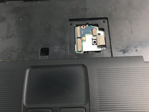

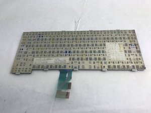

+[* black] The keyboard is now successfully removed.
