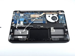

+[* red] Pull back the silver battery connector lock with the plastic opening tool. This should slide back and should require minimal force.
+[* orange] Lift the battery connector vertically using the blunt nose tweezers to remove it from the socket.
+[* black] Take the battery out once you have unplugged this connector.
