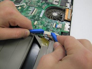

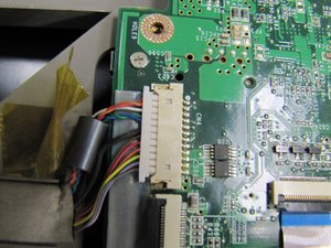

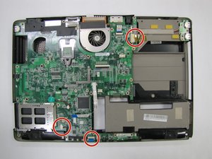

+[* black] Replacing the Motherboard will require the removal of 2 white plugins and 1 ribbon cable.
+[* black] Begin with the white plugin in the upper right hand corner.
+[* black] Use the Blue iFixit Opening Tool to pull the plugin out.
